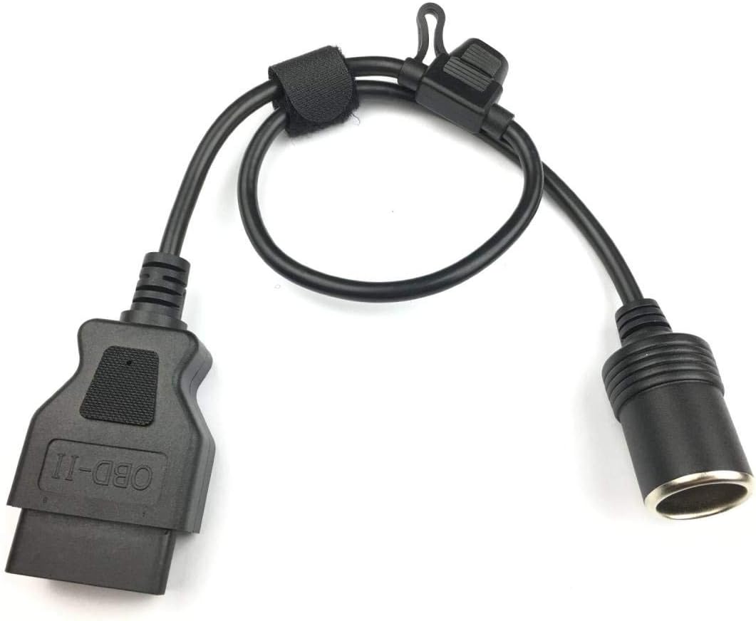

You can also get a plug to go into the OBD port on bottom of the dash.

I’ve since learned there’s an easier way to connect the solar panel: through the OBD port.
good to know!
