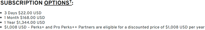

That sounds like an inflated number, used to try to scare people. OEM service access is available to purchase for less than the cost of a breakfast sandwich every day, meaning you can get what you need by buying anything from a 2-day subscription to a full year depending on your needs.
You want factory level complete access to anything and everything to repair and program a Ford product? Buy a subscription to Ford Diagnostic and Repair System:
You work on a lot of GM cars? Service Information is available to you as well:
Maybe you need Toyota software as well. That can be had as well:
You’re working on a Chrysler product and found that the TIPM has failed and needs to be replaced and configured. WiTech provides access by the VIN and each separate vin requires a separate yearly subscription, for the princely sum of…$35
Now granted these prices don’t include hardware, but any repair shop in business today that is doing this level of repairs is already using several laptops and interfaces and has the entire facility wi-fi’ed, etc. Or is the business in question one of those discount places that takes over every old 2-bay gas station and muffler shop?
Bottom line, if you’re replacing a power window switch that needs factory level programming (yes that exists), and you can’t find your way to a $22 3-day subscription to do the work, you’re not fit for this industry.
