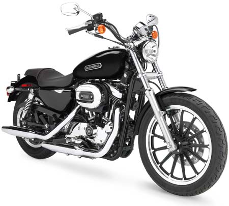

Ah, I don’t know about that… My Harley Sporty got all of 34mpg and with a ‘peanut’ gas tank that held all of 3 gallons, I could go maybe 100 miles if I kept it at an even speed.
Most road tests on Sportsters that I have read inicate that they can get low to mid 50’s on the highway, provided they are left stock and some shade tree mechanic keeps his grubby mitts off of the carburetor jetting.
