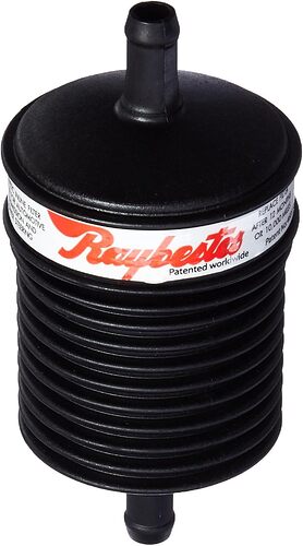

Just wondering, and I would never do it, could you splice in a filter in the transmission cooling lines? Use a spin on oil filter.
Of course do this after the vehicle is out of warranty !
Here is one for ya’ll, new lawn mower, can only change the oil by changing the filter assembly. Filter is prefilled with oil. Only changes about 1/3 of the oil volume.
Yes of course you can, I have done it many times when installing a rebuilt transmission… IIRC some of the reman transmissions came with inline filters that we had to install for the warranty…
https://www.amazon.com/Raybestos-Powertrain-Automatic-Transmission-suppressed/dp/B0065LZA94/ref=asc_df_B0065LZA94?tag=bngsmtphsnus-20&linkCode=df0&hvadid=80539426823202&hvnetw=s&hvqmt=e&hvbmt=be&hvdev=c&hvlocint=&hvlocphy=84232&hvtargid=pla-4584138895698230&psc=1&msclkid=b292e77e41ad18fb0afb8fcbb672f550
2:51 pm
I’ve run into many of those filters that were installed afterwards, at some point
And I’ve found that in nearly 100% of the cases, the steel lines were NOT cut and flared correctly where the new bulk hoses then connected to the added filter . . . which absolutely guaranteed that those hoses would one day blow off, which I did experience many times. Some guys even made a straight cut into the steel lines and doubled up on the hose clamps, patting themselves on the back and proclaiming “that will never loosen and come off” . . . yet it did
So, in many cases, the guys adding those filters created problems where none previously existed, and also ruined a perfectly good trans cooler line
I have seen the same, but I always flared both lines AND double clamped both ends of the hose… If done correctly, it does help…
But I learned how to do it right from repairing holes in lines, cut out the bad section, flare both ends and double clamp the ends of the hose, never had a failure doing it that way…
