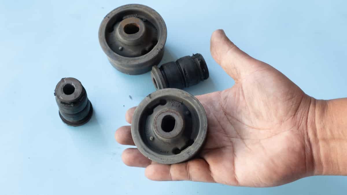

Here is a thought, go to a place (open parking lot when the business is closed etc) and have a helper drive the vehicle forward some and hit the brakes hard, then back up and hit the brake hard, does it look like the wheel is shifting (moving) forward/rearward in the fender wheel opening?? if so then probably needs bushings, if you see very little (slight) movement then don’t worry about it and move on with your life..
The front lower control arms rearward bushing is a pancake type bushing and they are known to crack and allow access movement in the control arms, it can also make the vehicle try to shift lanes when/if going from acceleration to braking kinda fast…
This is assuming you are talking about the front suspension…
Here is the bushing and then the control arm w/ bushing…
