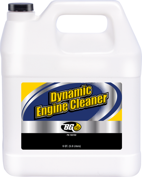

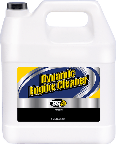

I have no idea what a “dynamic engine restoration” is. But either way, these items would not address a complaint of smoking, except on a stretch maybe the injection service.

You should have deferred the maintenance and brake repairs until after the engine problem was resolved, there is no point in replacing the coolant or power steering fluid if the engine needs to be replaced. The “Dynamic Engine Restoration” was a long shot, unlikely to have restored that engine.

Pour some elixir in the engine and drive around for a while hoping it will dissolve the sludge and restore the engine…not likely.
