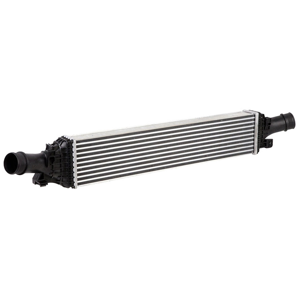

The intercooler for the turbo failed in some way that allowed water to enter it, and the turbo pushed the water into the engine.
Since the intercooler sits very low at the front of the vehicle, it’s the only way I can think of how water got into the engine.
