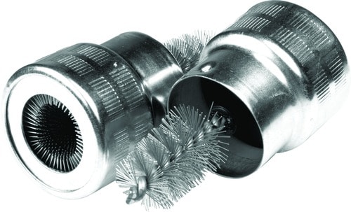

Most likely your battery cables are corroded. Take them both off and clean them with a wire brush. The one made for battery terminals works quite well.
All parts places sell them:
http://images.oreillyauto.com/parts/img/large/pfm/20134.jpg
