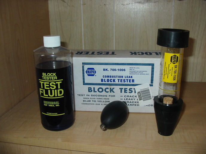

Use a block tester to determine if you’ve got combustion gases in the coolant. Follow the instructions. If the fluid turns yellow, that’s a bad sign. Could be a blown head gasket, cracked block or bad lower intake gaskets, depending on what kind of engine you have. It could also be a few other things, but you’ve got to start somewhere.
