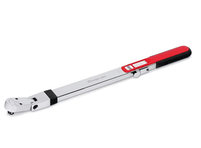

My old work, as of retirement 2021, we used all Snap-on torque wrenches only for lug nut torque, they were swapped out every 6 months to be recalibrated and or repaired… Before Covid, they cost the company about $180.00 each…

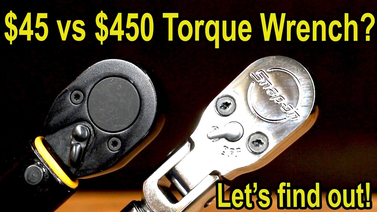

Check out this video. I have 2 Craftsman torque wrenches, one of which is 60 years old.
