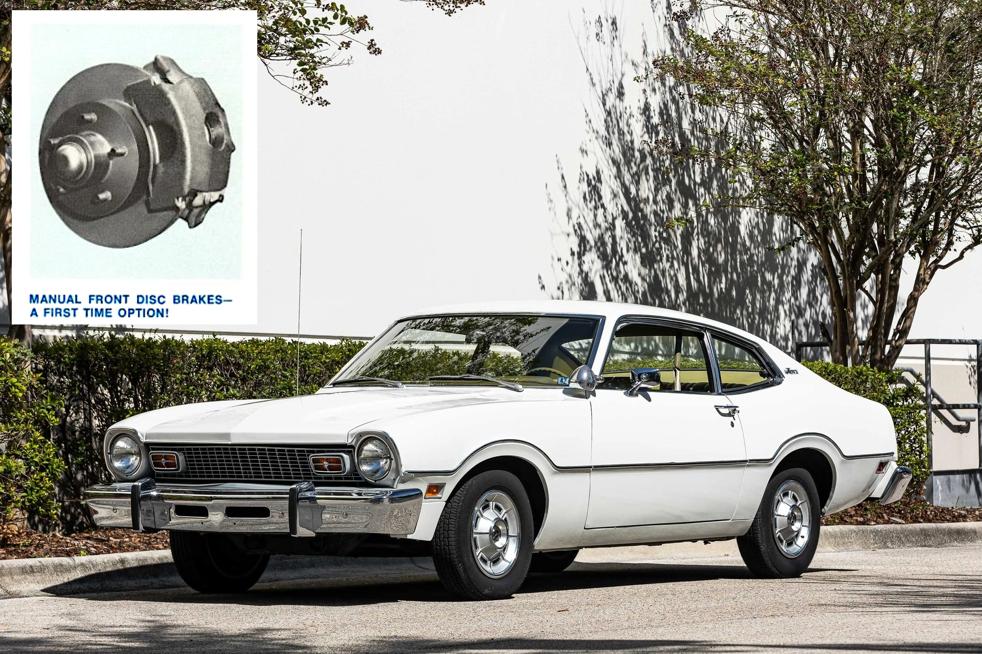

Here’s an interesting article about some of the earliest automotive disk brakes:

Good article. This paragraph was definitely interesting:
The biggest sticking point was inevitably cost, but car companies were also reluctant to impugn the effectiveness of drum brakes or to imply that drums were in any way less safe (even where they demonstrably were). Not only would that have opened automakers to legal liability, it would also have invited government regulations requiring discs and perhaps antilock braking systems.
As it was, new federal regulations that took effect in 1970 required automakers to publicly disclose their cars’ braking performance in a standardized 60 mph to 0 test, data the NHTSA began publishing for the 1971 model year. Cars with disc/drum brakes didn’t always delivery outstanding performance in those tests (although cars with four-wheel discs almost always did), but cars with four-wheel drums frequently fared poorly.
