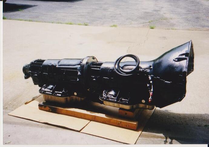

Speaking of which, I am a big fan of that feeling also :smile: I posted some years back about a transmission I built with the help of a friend to complete a challenge I made for myself. Child’s play for someone with your background and abilities. I still recall Mustangman was able to figure out pretty much every detail about the transmission and its advantages just from a picture of it. I remain impressed by that to this day…
Here’s a pic or two of it-
Not as impressed as I am with you joining 2 transmissions together… lol
My hats off to you sir!!! And Mustangman for understanding it right off!!!..
I have to really think about it hard to wrap my simple brain around it and I still probable have a 1000 questions…
I would love to slowly disassemble it to see how you did it, then I could possible understand it, but I might also look at it and go duh, why didn’t I think of that…
My issue is I overthink everything when sometimes it is just something simple…
But man I bet with a double 1st gear, that thing would launch Hard with the right suspension and tire setup…

I was very impressed with the machine work and hydraulic controls in that double transmission.
I owned a C4 Corvette with the 4+3 manual…. Basically a BW T10 with no-reverse Powerglide bolted on so the concept was familiar.
It’s part of the overall package design. The original intent was to be able to drive to the strip and beat some friend’s trailer queens. The engine power band, torque converter stall, transmission and rear gearing all work together to accomplish the goal.
The trans itself was a fun part of the build. I wanted something unique versus buying a Tremec or similar. Many challenges to overcome building a custom semi-automatic 5 speed. The custom shaft between them was interesting and challenging to make sure it was well aligned and not destroy itself under load or high speed rotation. Some hidden details- the pump is in front naturally so the pickup is a 3/4" PVC pipe that runs from the pump inlet in front pan to the back pan through the larger pipe/hose connecting the pans together. The larger pipe allows fluid to drain to the back pan/sump. The front trans has the forward gear sets, back has full complement.
They have reverse ordered manual valve bodies and are controlled by two separate ratcheting shifters. The line pressure is significantly higher than original design for very positive shifting. The units “freewheel” in all gears except 5th. This helps to prevent issues if I had to let off the gas rapidly during a pass. If you let off the gas, it returns to idle and coasts. This also turned out to be beneficial on the street when passing cops :smile: Later I regretted doing that as I like the sound of a big block engine braking with a manual.

Any idea what your low gear (1st(s)) gear was, or what the gear ratios were, even if distorted a little to keep them a secret, just trying to figure out if stock or double (stacked) 1 gear, any overdrive to it, or just 5 close ratio gearing???
Soooooo many question, mind blown… lol

OK, now you’re really challenging my memory. LOL
1- 6.25
2- 3.75
3- 2.50
4- 1.50
5- 1.00
I had to go back and look to be sure but it’s a 3:08 rear gear
Sooo, total gearing is then
1- 19.25
5- 3:08
Let me see what I might have…
And I thought I was impressed with the Wide Body ScatPack’s 8HP70 8 speed and it’s 4.69 1st gear and 3.90 rear gear for a 18.29 total 1st gear… Gezz that thing Had to pull hard, and I know 2nd came Very quick… HellCat’s 1st gear is only 4.71, don’t remember the rear gear ratio…
My fun car pulls harder in 1st (and 1st only lol) than the ScatPack, and I am only running a 2.45 1st gear with a 3.91 rear for a total 9.58, I can’t even begin to imagine a 19.25 total…
Mind BLOWN even more now, heck, I stopped trying to figure out how you got your ratios, nope not even gonna try, to much math for my neanderthal brain… lol
