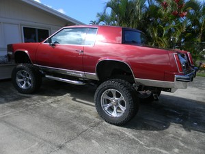

Also considering this:
Since it has the same wheel base as the 3rd gen blazer. How much is a chassis swap though? o_O
