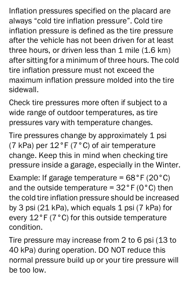

For automobile tires the standard is 1 psi = 12 degrees F.
And the owner’s manual even explains how to compensate for garage/outdoor temperature differences.
You used gauge pressure instead of absolute pressure. 33 psi-gauge is 47.7 psi-absolute at sea level and 36 psig is 50.7psia.
Rerun the calculation with absolute pressures and you’ll see the value I did.
