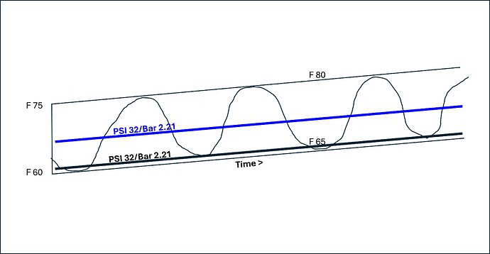

I would like to know the groups thoughts on the following two cold tire inflation scenarios.
The first one represent s fairly steady daily temperatures, with a rising trend typical of June in north American climates. Instead of adjusting cold tire pressures at the coldest part of day, one could argue for adjusting them at the mid-point temperature, perhaps 3-4 hours after early dawn, as represented by the blue line.

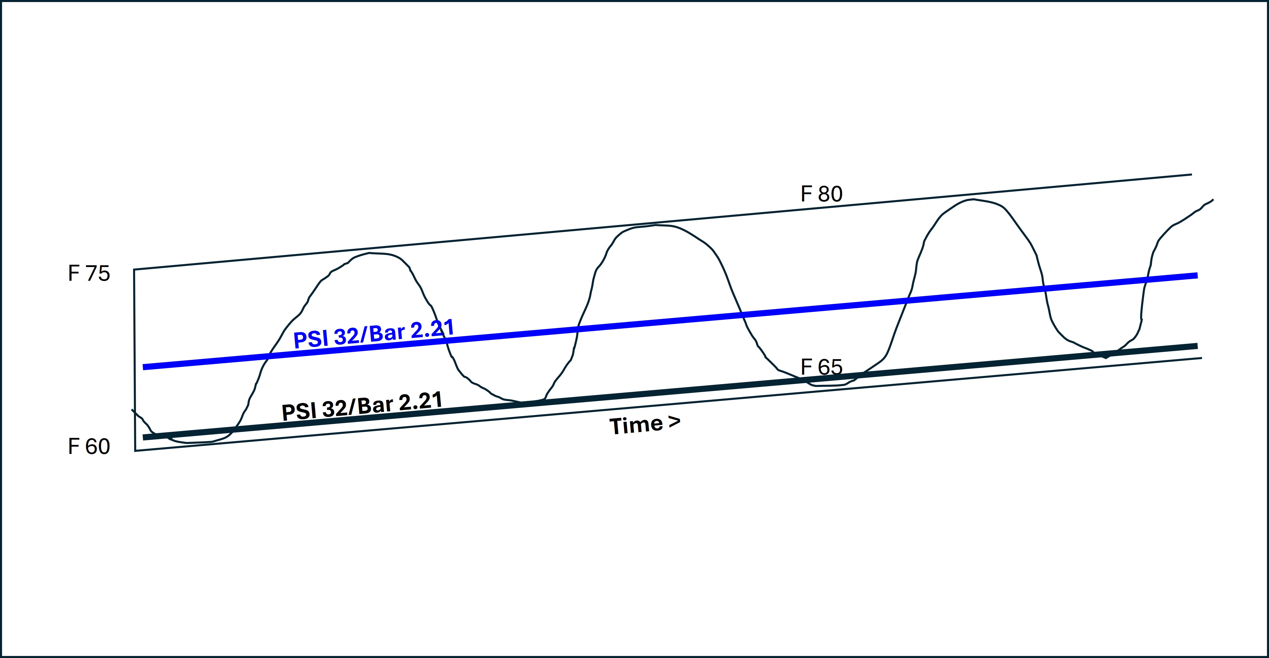

The second daily ambient temperature model is probably more realistic, at least post-2000.
How one handles that second model is anyone’s guess…
So you think a tire that has sat overnight is not at ambient temperature?
One could argue that, but one would be wrong. When the manufacturer figures out the recommended tire pressure, they take into account that the temperature rises during the day.
The other point to make is that people can make more out of this than necessary or warranted. It’s really not that critical. If it was, you would see much more detail in the process of pressurizing your tires.

When I think of ‘cold tire pressure’, I interpret that to mean ‘before any driving that day’. I’m fine checking my tires at noon, as long as I haven’t driven up until then.
