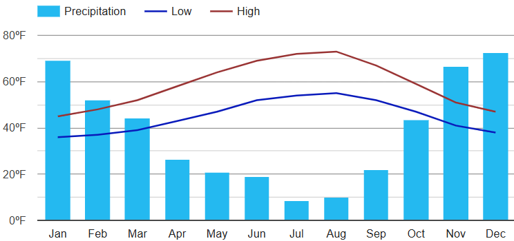

Well, to be fair, the climate where I live is much more forgiving towards rubber components than where you live.
It was 66 and partly cloudy today. How about at your house?
