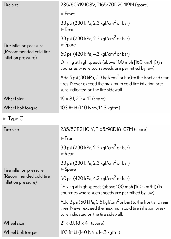

That is a myth based on the wear characteristics of bias ply tires, radial tires don’t flex in that manner with increased pressure. I have inspected tires on many Lexus RX350’s, tires last longer on vehicles with tire pressure greater than 40 psi.
Lexus recommends increasing the tire pressure by 5 or 8 psi (depending on tire size) for high-speed driving. Drive at high speeds with tires inflated to base pressure is a greater hazard than it is increasing pressures by 10 psi.
