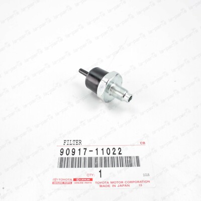

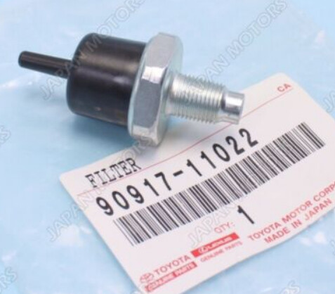

That’s a thermal vacuum switch.
I’ve been searching online, and so far I’ve seen that referred to as a MAP sensor filter or a gas filter. I cannot find any references to a thermal vacuum switch.
It is a filter, it prevents PCV gasses from causing sludge in the vacuum hose and sensor.
Is there sufficient air flow through the vacuum hose while the engine is running?
The MAP sensor input to the PCM can be monitored with a scan tool.
Thank you for confirming that. I get no check engine light from the MAP sensor, there are no error codes in the computer, and even at higher speeds it will not throw a code. The problem with my car, as described above, has stumped the mechanics at the shop. I replaced the MAP sensor today myself and there was no difference in how the car ran, but when I spotted that device I wondered what it was and if THAT could be the problem. So I’ve been searching online for any information on it. It’s hard to find though. Rockauto doesn’t have it, though I can find it on Amazon and eBay. :slight_smile: So I’m gonna order the one from Amazon and see if that will fix the problem.
Again, thank you!

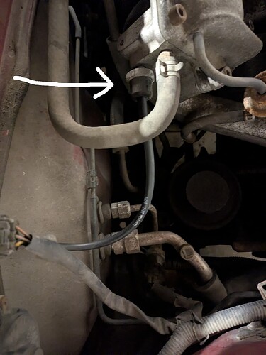

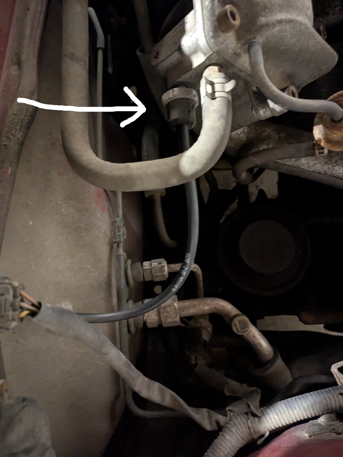

See, sometimes a pic is worth a 1000 words… Thanks for posting…
Now:
But did you see this??
and then this??
Have you at least tried to blow and suck air through the hose?? or even put your finger on the end of the hose at the MAP sensor to confirm vacuum??? Or you can just keep throwing parts at it and hope one sticks… lol
A little diag can go a long ways sometimes…
