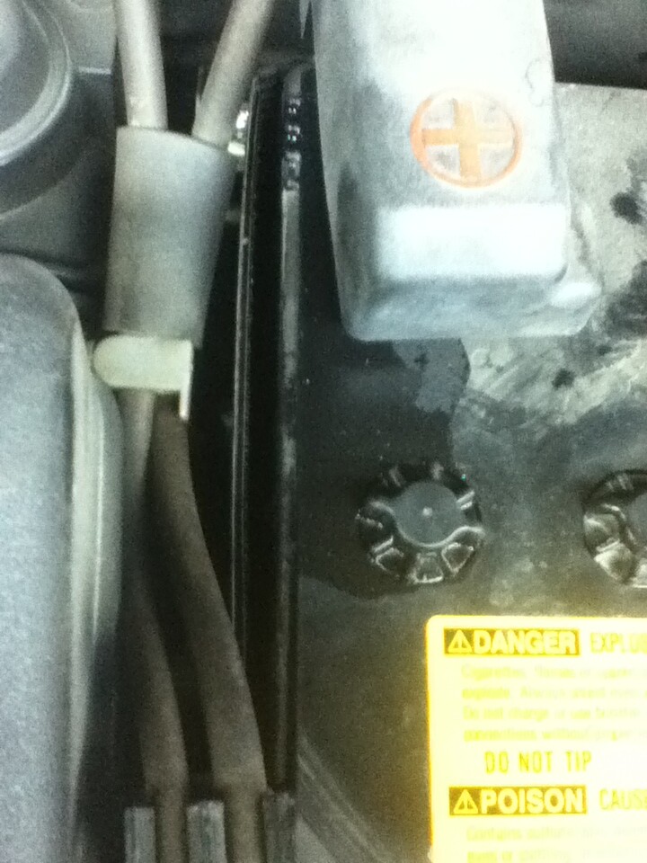

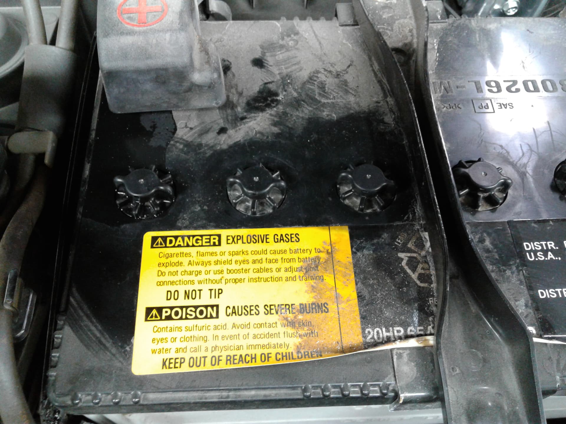

The picture below is of a 2015 Lexus RCF battery, the owner was a 75-year-old man who thought it would be helpful to “top off” the battery. The electrolyte expands with heat, after operating the engine there was acid spraying from the vents that caused damage to the paint.
I have performed many battery acid damage repairs that should not have occurred, the electrolyte level should be good for the life of the battery, do not add water to maintenance free batteries.
