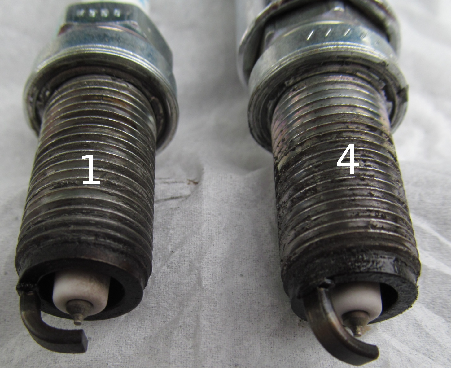

I finally got around to pull out the spark plugs and check the cylinders for myself. I pulled #1 and #4 in order for comparison. Here’s a picture of the plugs with #1 on the left and #4 on the right.
I did not see any liquid in either cylinders, although, I could only see straight down with my flashlight. However, the bottom of cylinder #1 looked very clean while the bottom of cylinder #4 looked like it has a coating or film of some kind on it that was a little shiny.

I could be wrong but that looks more like oil at the end of the threads on #4.

Those plug tips look to be in pretty good shape. I don’t see anything unusual at the end of the plug anyway. Have you verified the gap is correct?

@GeorgeSanJose‌ - I didn’t check the gap, but the plugs only have a few thousand miles on them so I don’t know if I would expect to see that kind of wear yet. Maybe I would given the way my car starts sometimes though.
